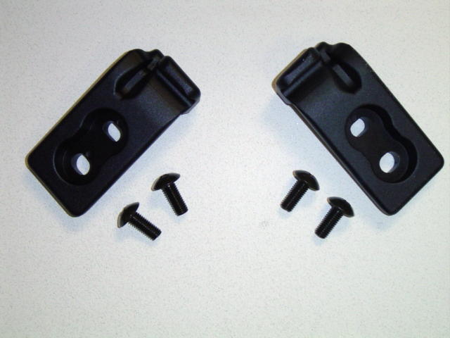

Are you talking about just this part your having to grind?
http://www.miata.net/garage/hardtop/Plate%20Kit.jpg
I have this bar and run it with a hardtop with no grinding without a problem. It sounds like you could have ended up with the M2HDHCDD (non-HT version).

i had grind off a little bit, but it fits w/ the hardtop! :)
which part did you end up grinding off to get it to fit?
a little off the side ... probably no more than 1/8"
