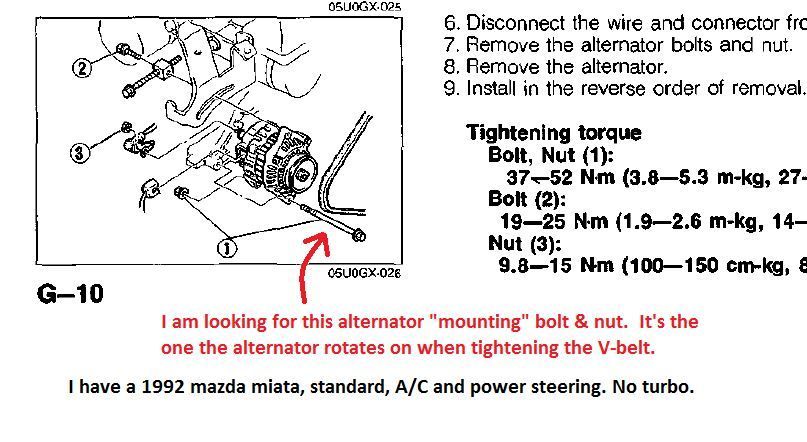

I pulled into the garage thinking I would tighten up the V-Belt on my alternator because it was squealing. To my surprise the bolt is gone.
So,,, how do I find out the correct size bolt to replace my lost one and who would have one within the DFW area?
I have a 1992 Mazda Miata, standard with A/C and power steering. No Turbo.
Thanks for your time,
http://i1106.photobucket.com/albums/...tor%20bolt.jpg
