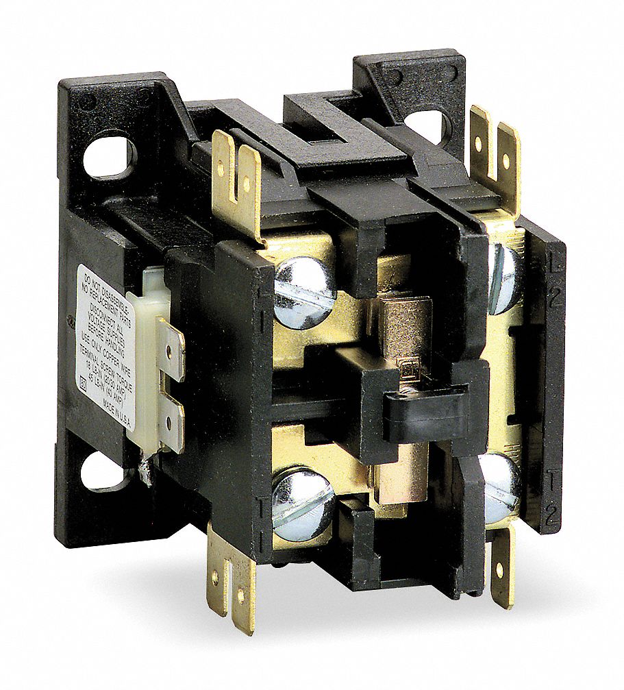

The contactors are also a weak link as well as the capacitor.
http://productimages.grainger.com/is...productdetail$
