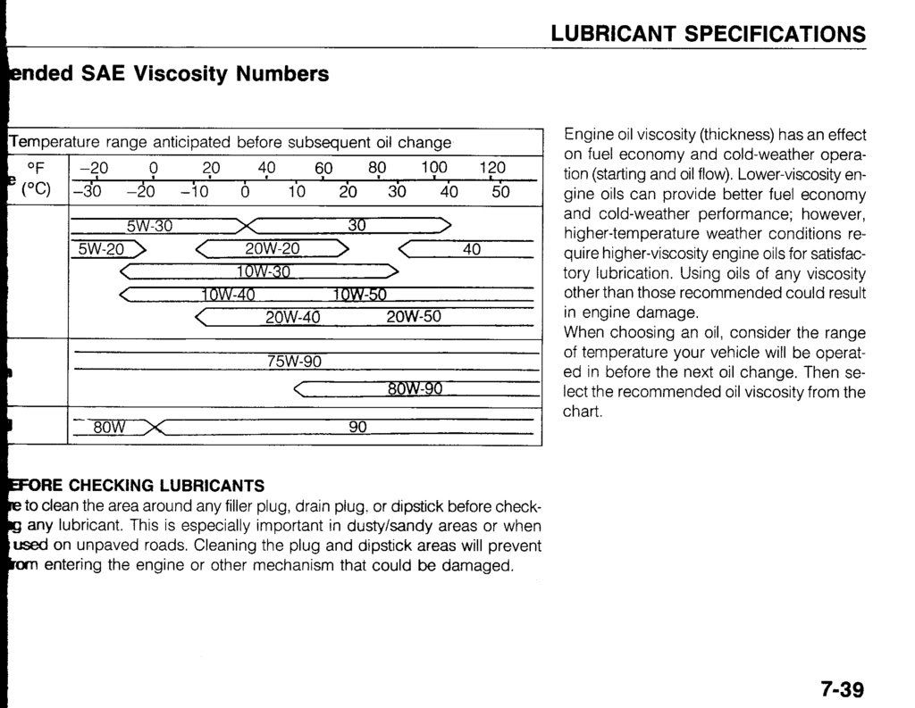

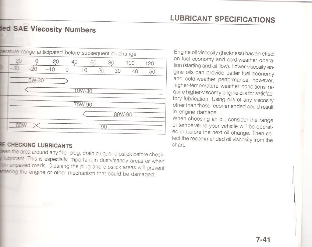

Funny you should mention this. Take a look at the recommended oil viscosities from a 90 Miata owner's manual versus a 91.
http://i275.photobucket.com/albums/j...hoto/90oil.jpg
http://i275.photobucket.com/albums/j...hoto/91oil.jpg
