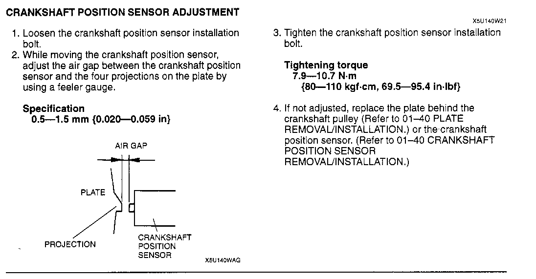

You sure when the Crank Possition Sensor was installed it had the propper air gap?
This blurb from earlier makes me wonder - DTC is set when PCM input signal from Crankshaft Position
(CKP) sensor signal is irregular.
You had mentioned the Crankshaft possition sensor had been changed.
Here is a screen capture fromn my '99 service manual (I'd figure the '01 should be the same)
				New wires on the way, and I will check this air gap when I get home today. Thanks for the info
