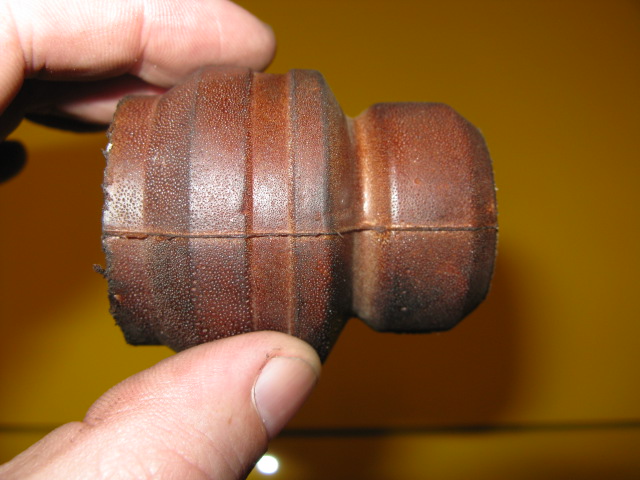

    Here is my question the bumpstops on the Bilstiens are toast, but I have a set of NB bumps stops, can I put these on the NA shocks and make my own TCB Fatcatish style setup?

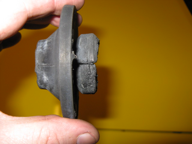

    Here is one of the bumpstops off the Stiens it is toast.....
    Here are one of my NB bumpstops.

    Yea I know the material are different figure the 58 mm lengh of the NB bumpstops should give me more than enough protection from wedging them down, I hope....

    Here is only decent bumpstop to come off the back of the car vs. the NB stop. The measure virtually the same height, but the original is cracked and compacted from what a new one should be.
    Creek Brought up the possible need for a fender washer but the NA hat didn't appear to need one. I did take the original washer of the old bumpstop and used it and as you can see there is a decent surface for the bumpstop to ride on.
    Old vs. New(er)
    Installed
