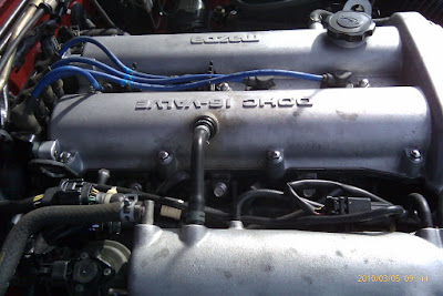

The PCV valve gasket in my Valve cover is allowing oil to pass and making my valve cover dirty!![]()
I tried VatoZone and the guy didn't have a clue (not a big shock) but not sure if I didn't describe the part properly or what...
What is this gasket called that the PCV valve goes in in the valve cover and where can you get one locally?
TIA

Mazdaspeed just calls it a seal.
E301-13-338A SEAL
I ordered one last month, but have not installed it yet.
Town North has one for $3.80. I just called them to see if they had one and to compare with the Mazdaspeed price.

FYI, MS price is $2.28! Reason I know because I just ordered this thingy. Wish I know you are also looking for it.

Well the NAPA part worked great FWIW.![]()
