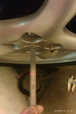

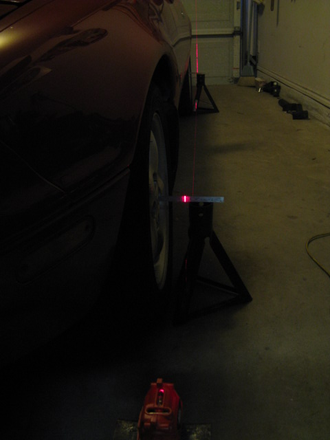

Wanted to measure my camber on the car so I got a laser line and set it up on the car. The laser line unit I got allows me to setup one to get all the measurements on one side of the car. With the old school string method you have to set up a a string for the toe and a plumb bob setup for the caster.
First I set up the centerline of the front and rear including the 10mm track difference between the front and rear.

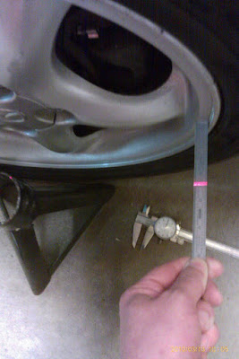

Now using a simple rise over run calculation I was able to determine my current toe & camber angle (No Driver in car)
Driver-side Rear
Toe = -.125" or .447 Deg
Camber = +.375" or +1.373 Deg
Driver-side Front
Camber = +.312" or +1.119 Deg
So it looks like the toe is in Mazda Specs and I plan to mess with the camber to see what happens.
But I have messed with the front camber using the plumb bob method but that was because negative camber just doesn't look cool.
So what do you kids think is this a decent TCB way of checking alignment on a Miata or have I missed something critical? I know I need to get the car level in the garage and plan to do that step as well before I get all crazy.
