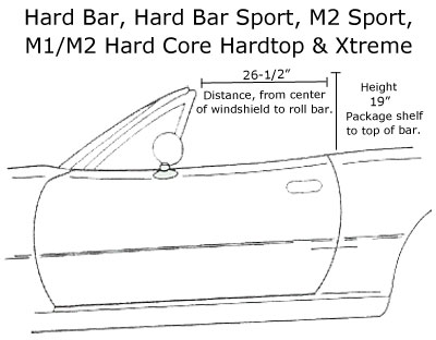

    Just a note...taller means it will sit more upright (read: closer to the back of your head).
    This may help -
    http://www.bethania-garage.com/image...m1m2hcht_x.jpg
    You can see the schematics for all the bars at the website above.
