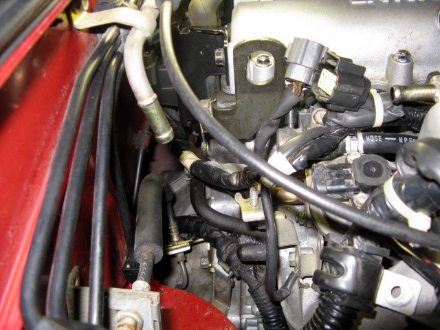

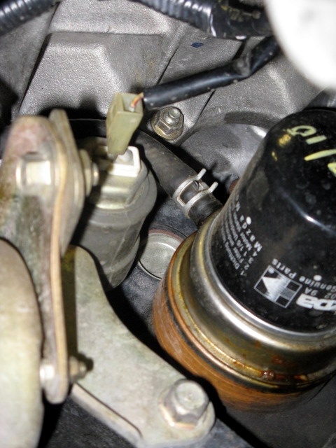

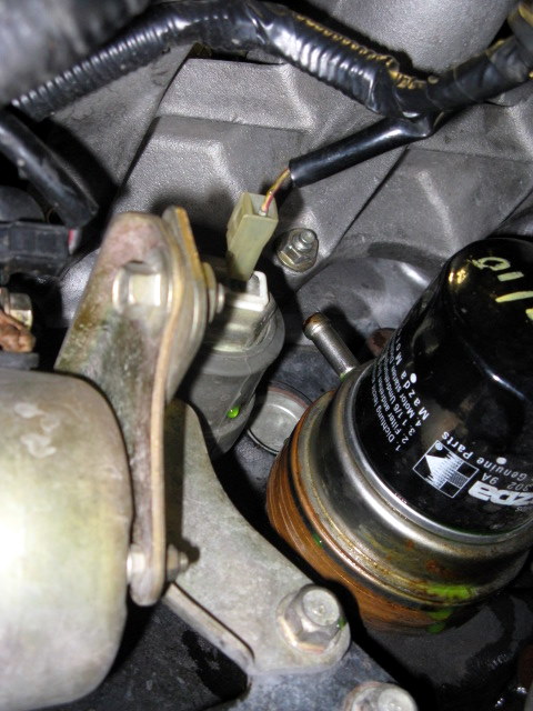

    Wow what a PITA!
    Pulled the Vacuum line.
    Disconected the wiring harness....

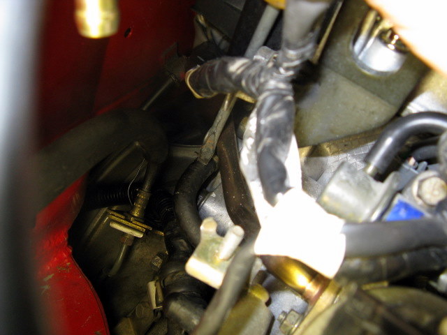

    Now I can see the evil leaky hose (Screw driver on the hose)
    Wrestles the hose clip loose and disco the hose....
    Now on to the lower connection.....

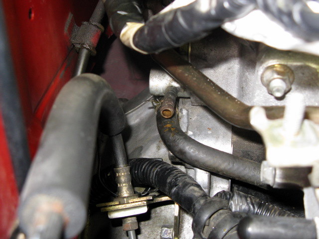

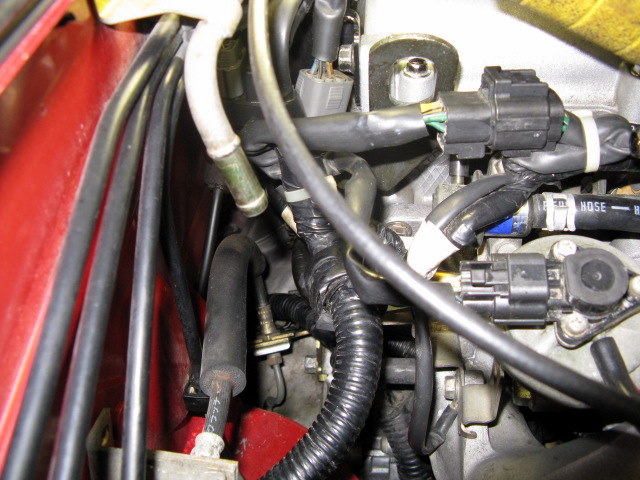

  11. #31
    Lower Connection easiest way I found to get to it was to pull the right front wheel and reach in through the wheel well.
    Disco the clip and hose.

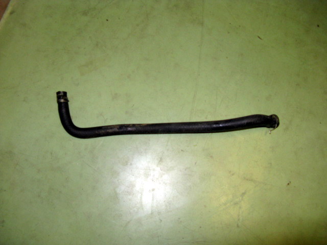

    Fish the old hose out throw it on the garage floor and swear at it !

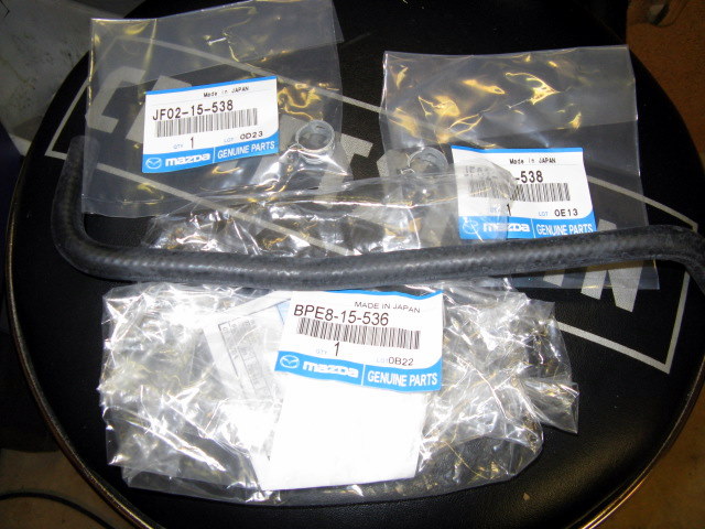

    Now reverse the entire process and install the shinny new parts.....

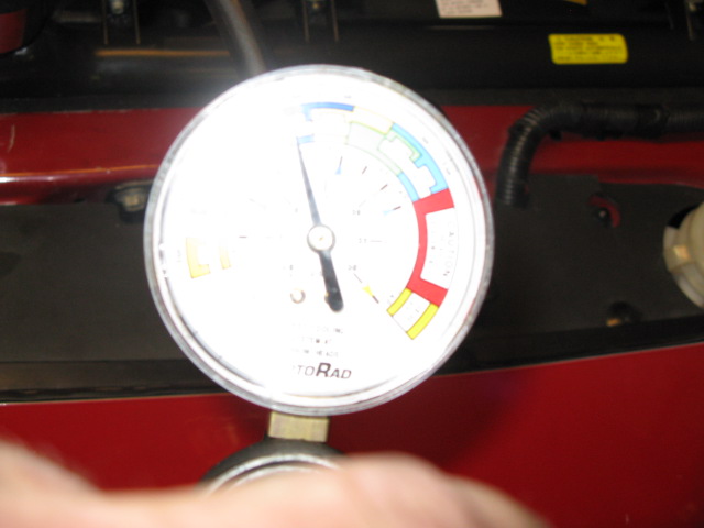

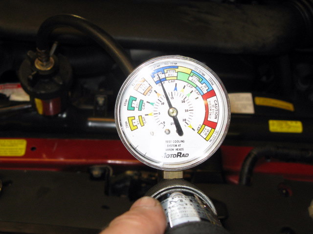

    Now refill the system and pull out the old pressure tester...
    Pressure the system up!
    Wait about 20 minutes and see if the system holds pressure to make sure there are no more leaks. (Sorry about the glare)
    It is holding pressure so I'm thinking it is fixed.......
    The new clamps were a great plan since they are open with a safety clip on them you move them into position and pull the safety with a set of needle nose pliers and the clip is on!

    Wait about 20 minutes and see if the system holds pressure to make sure there are no more leaks. (Sorry about the glare) It is holding pressure so I'm thinking it is fixed.......
    Well, I can tell the needle didn't move, but there's no time stamp on the photos and I never heard you from my house
    I'll reserve final judgement until the next autocross.
