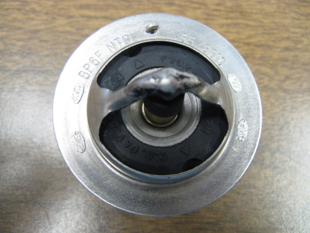

i used an oreillys auto parts one, should have i gone with an OEM one from Mazda ?

I don't know about NBs, but in general thermostats are one of the things I will always get OEM. (I did have a Nismo thermostat on my Z, but that's technically still OEM)
Not saying that's your problem, or that OE parts are always 100% not defective, but it's a possibility. Pull it, and put that thing in a pot of boiling water - see what it does (half kidding).
Yeah i was reading around and i read the OEM stats have the double valve and alot of the aftermarket miata ones only have one valve, perhaps thats why it doesent warm up all the way ?
Yeah i run the stock thermostat in the Z but the Z's Cooling system is alot harder to maintain and work on then the Miata lol
As much as you probably don't want to hear it, I would *start* by putting in a Mazda thermostat and see if it improves. If so, money wasted, lesson learned. No biggie. If it doesn't fix it, you at least ruled out one variable.
Then, I would personally put the thermostat you have now in a pot of water, stick a thermometer in there too, and see what temp makes the thermostat start opening, and at what temp it's fully open. Then watch it as the water cools, and note how long it takes to fully close. But I'm a nerd like that, and that's why I was half kidding about actually doing it.
Yeah im going to get an OEM mazda one and hopefully that takes car of my problem, ive already flushed the radiator, changed the coolant temp sensor, put the 180 stat from orielys, and burped the radiator several times and changed the cap.

It sounds like your thermostat is sticking/stuck open. I can't imagine that happening to two different thermostats instantly, although it very well could be possible. If you didn't properly burp the system, you'd have overheating problems, not overcooling. Same with crap in the radiator, as well as a faulty cap, and your fans being bad. So I would definitely look to something with the thermostat...Sorry, thinking out loud.
