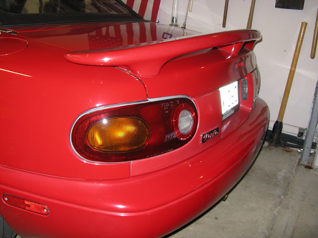

You could get a can of prussian blue marking dye and put it on the center hole mount. It would transfer to the car and give you the exact location.
