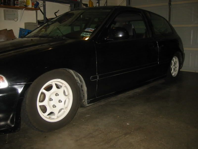

    scrape or go home :)
    old civic before i raised it up some. rocking 13"s ... the toe of my shoe would be stuck under my car if i tried to put it under lol
