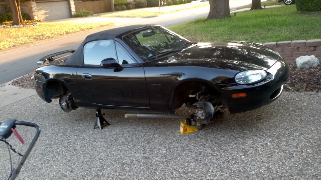

    So, time goes on and vibration gets more intense, now I can feel it, not just hear it. So I decided to jack up car with both rear wheels in the air. Took off wheels, brakes and rotors.

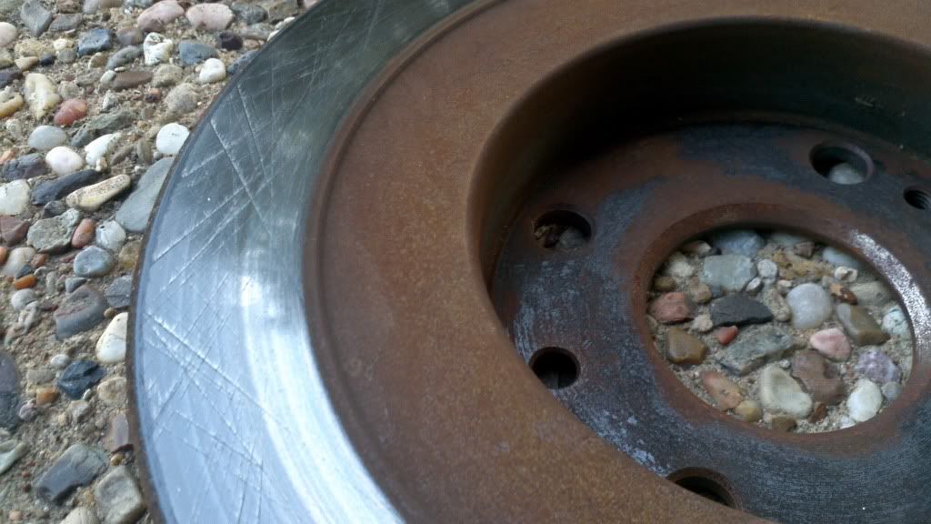

    The right rear rotor has a ton of scratches in it, but only on the inside surface. I will post picture soon.
    Is it possible that the rotor is bent? Or is it more likely that the hub or axle is bent, causing the rotor to not spin straight?

    Would a bad bearing really cause the rotor to become etched on the inside?

    Yep crack a curb can kill a bearing.
    The brake issue is more that likely a hung slider pin issue when was the last time you lubed the slider pins? Also your noise could be the brake dragging.
