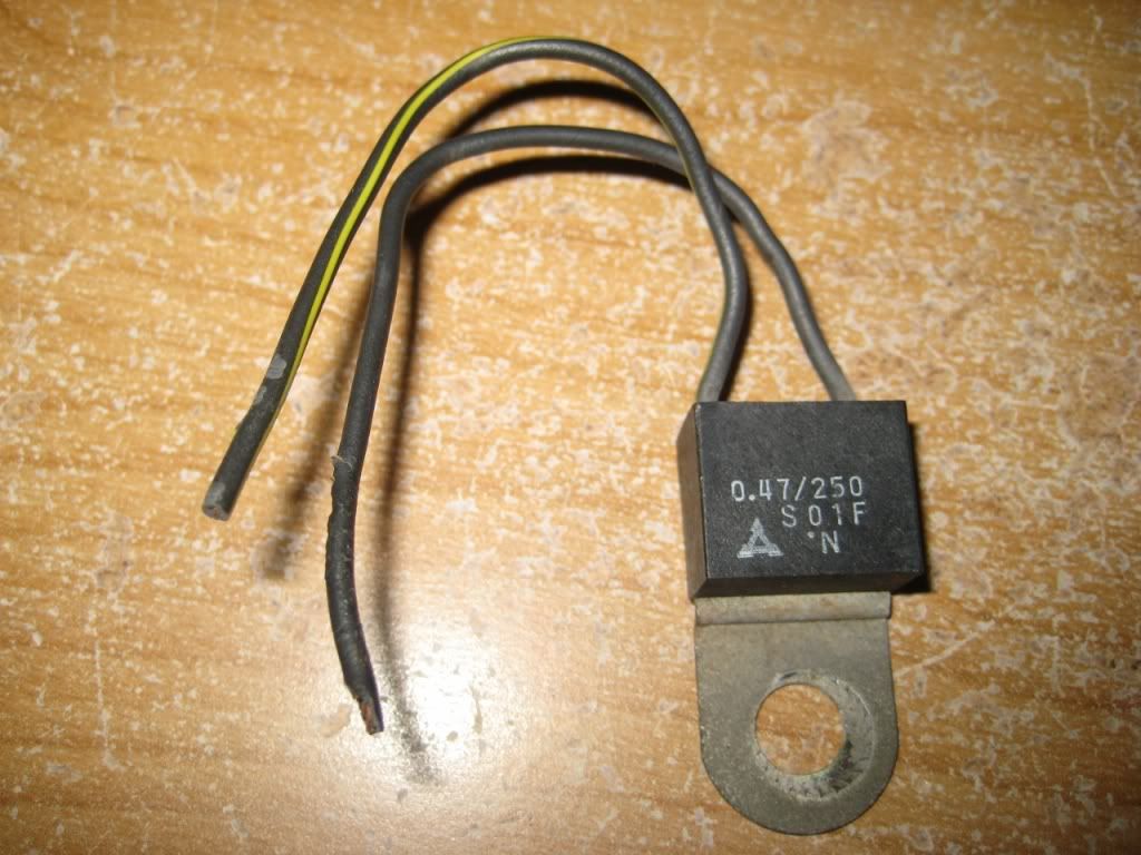

Anyone know what that thing does? Anyone have another laying around? A mouse/rat decided it needed the wires more than I did. The car still runs but I am not sure if anything will be burned up because it is not in the loop.

No flames, no funny noises, no nothing. It is on my son's 1990. I swapped the one from my '92 into his and no difference on either. But, being an engineer, there has to be some technical reason for it (I am not an electrical engineer so out of my field). I am pretty sure we have at least one EE on this forum... or some EE could-be's. I would rather just replace it if I could find a TCB deal. The pointy board seems to be rather silent on the whole subject also. Differing opinions only, no real insight or even part number references that I could find. A mystery part...

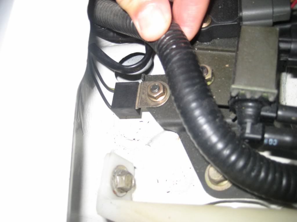

Finally can post pics again. Still no flames or any idea what its purpose is. Here is what I am looking for... First pic is of the mouse food. The second is where this thing is mounted on my '92 fender well.

In the absolutely most basic and generalized way I can say it (so I'm sure someone will chime in and say it more detailed): It's to stabilize the signal to the coil. Well, from the coil..it's on the ground side. If it's removed completely from the loop it will still run (obviously) since it still gets grounded after the PTU/ignitor. I have no idea what it will do without it, but I'd imagine the coils aren't working to their full potential...which you probably don't notice since I'm assuming you aren't maxing them out anyway. But I'd still replace it.
EDIT: Picture:
EDIT x2: Some how I lost my parts fiche for the electrical stuff years ago, so I'm no help on a part# for you, sorry. I can't remember where I got it either, so I could never replace it.
