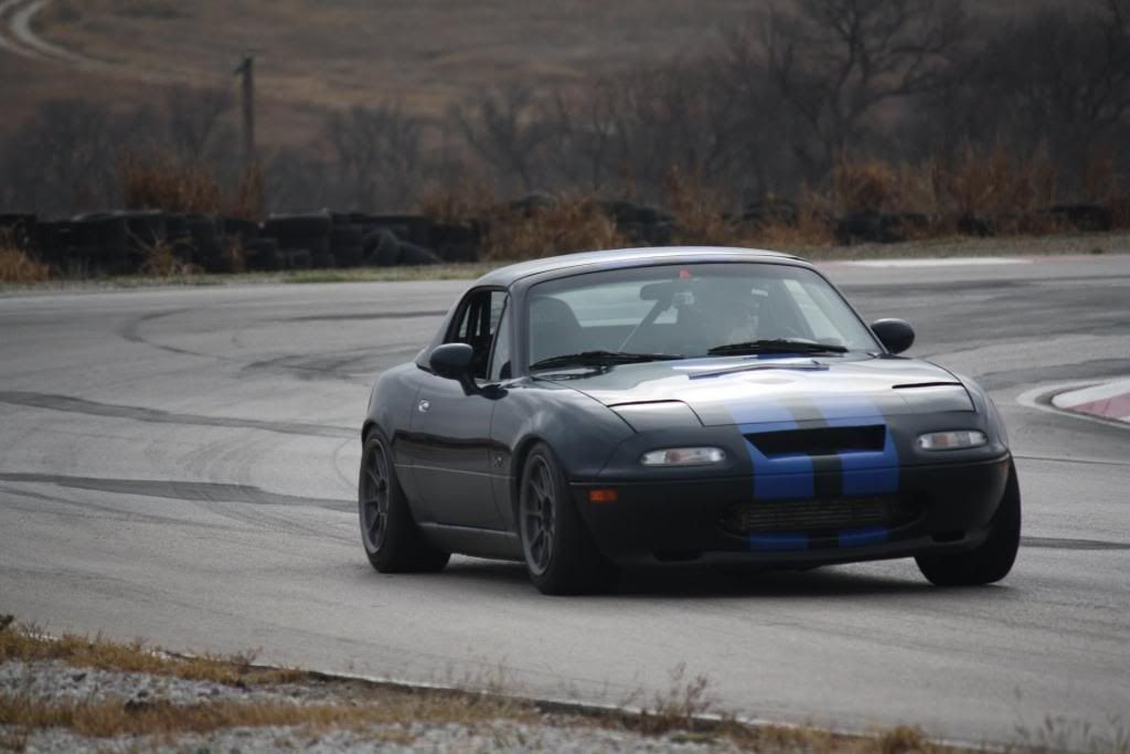

    Quote Originally Posted by shanem View Post
    mine is the 94m, which i think is green, with the bright blue stripes. There were a bunch of my car in the thread above.
    Nice. That photo is one of the ones I downloaded for backgrounds on my computer, lol. It switches to another photo of a Miata on the track every 15 minutes. So you're in the rotation. :)
    That's a nice looking car. Who did the stripe for you? Also, from that angle, it looks like your rear wheels are larger diameter than the front ones. Is that just the perspective of the camera or are they really bigger?
    Michael
  5. #125
    strathound
    Guest
    P.S. This is me in the red miata behind you in the foreground.
  6. #126
    I bought the car already built last summer, im not sure who painted it. the wheels are 15x9 with 225/45-15 toyo r888 all around. it's just the camera angle that makes them look bigger. You were in the brand new miata with paper tags right? Nice car.
