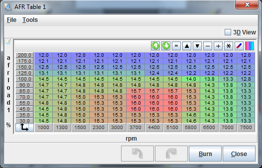

    Here's my AFR targets for reference. I've ran a handful of decently long autotune runs. I'll post my fuel map when I get back to my laptop. Still learning, but any room for improvement here?
