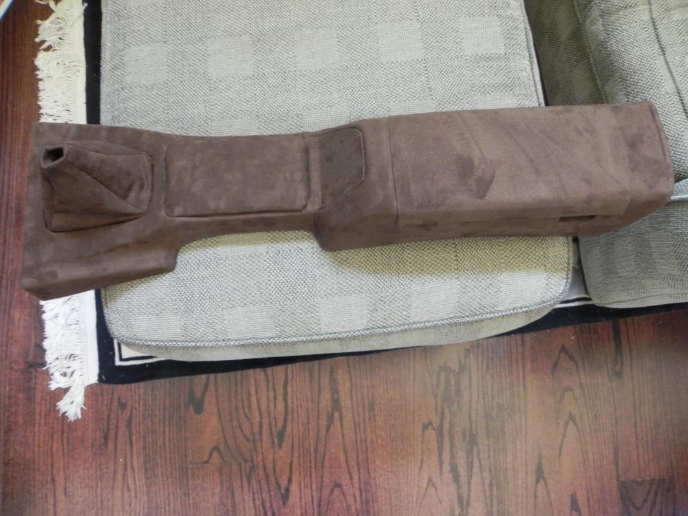

    Center console covered in cocoa brown Alcantara-like microsuede (but not Alcantara brand microsuede cuz it's $$$$).

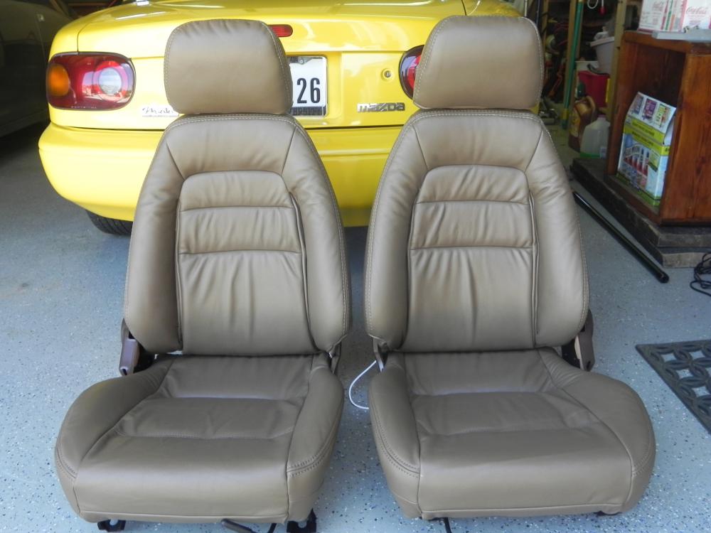

    95M seats covered in cocoa brown leather with speakers added to the headrests.
    Hopefully I will begin the install within the next few weeks.

    How do you keep the "Alcantara Like" material on the console? That has to be some mean glue.
    Thanks. I had success with Loctite brand spray adhesive when I did the headliner and other panels in my TT, so I used it again. Spray both surfaces, let tack-up, then bond together. Slow process and best when done in small sections.
