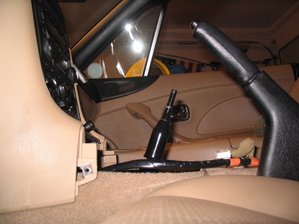

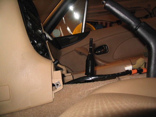

    On a 6-Speed car it is possible to put the shifter in wrong! We noticed after the boot changing to 1st, 3rd, and 5th gears put you hand into the radio. Found out we have the shifter in 180 degrees off. Mazda paints a yellow dot on the shifter, with it facing the rear of the car we punched the radio, with it facing the radio no problems!
    Here are some poorly done pictures showing the car in 2nd with the dot facing the back of the car or the radio, notice the different possition with the car in the 2nd, noticable difference!
    Dot facing the Radio (good)
    Dot facing the rear of the car (bad)
    YMMV
