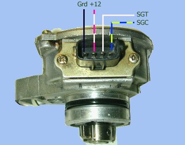

So I was able to determine I have a good ground 12V and two 5V on the harness as per the link.Quote:
If you don't know how to use a voltmeter, you should not be doing this.
With the connector oriented like this (tab up), the normal measurement is 0 volts, +12 volts, +5 volts, +5 volts. As shown, the black wire in the harness with be at the left
Also check the first pin (black wire) for continuity to ground
If the voltages and ground connection check out, the wire harness to the computer is good.

Electrical Test - per shop manual
You have to remove the CAS and attach power to it.
http://www.rivercityroad.com/garage/jpg/TEST_CAS.gifhttp://www.rivercityroad.com/garage/jpg2/cas_wires.JPG
The factory shop manual shows the above method for testing the CAS. Hook up power and ground. Then you need a load resistor and a 5 volt supply. With a volt meter hooked up to the resistor, you will read either 0 or +5 volts, depending on the position of the CAS rotor.
The SGC pin should switch between +5 and 0 volts twice per revolution.
The SGT pin should switch between +5 and 0 volts four times per revolution.
