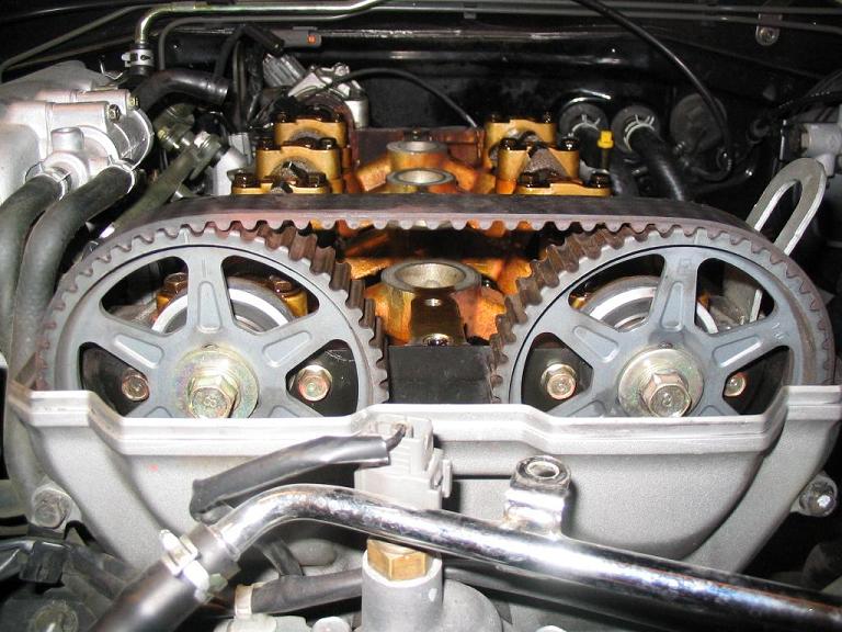

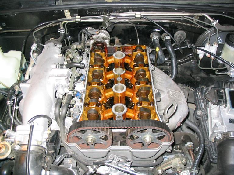

Got the hoses changed and the valve cover off, not as clean as I hoped...
http://www.harrisonindustrial.com/im...a/IMG_0912.JPG

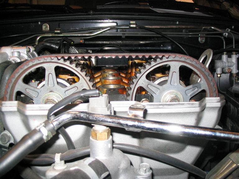

Also should this "E" stand alone on the pulley on the left? I need to crank the motor around to see if I can get the cams to line up.
http://www.harrisonindustrial.com/im...a/IMG_0913.JPG

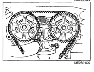

If you want, turn it some more and the marks should line up. However, on the intake cam, the e is in the Southeast position, The I on the exhaust cam is in the southwest position, and those corespond to marks on the head. The I on the intake cam and the e on the exhaust cam will point straight up at that point also.
That's clean. It just looks like you use dino oil and it tends to leave things a golden color. No black sludge build up which suggests poor maintinance.Quote:
Your golden! ;-)
Figure the last owner used Dino, has been on a 3 year diet of Mobil 1 ever since I got the car!Quote:
Originally Posted by black roadster
Looked like it was leaking around the CAS and the cams! Not a lot but enough to irritate me!
BTW> Thanks, Majik everything does line up one I cranked the motor around!
