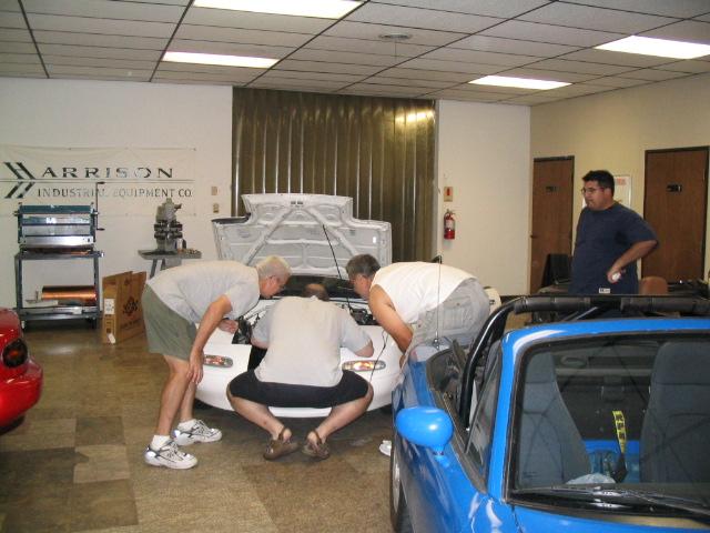

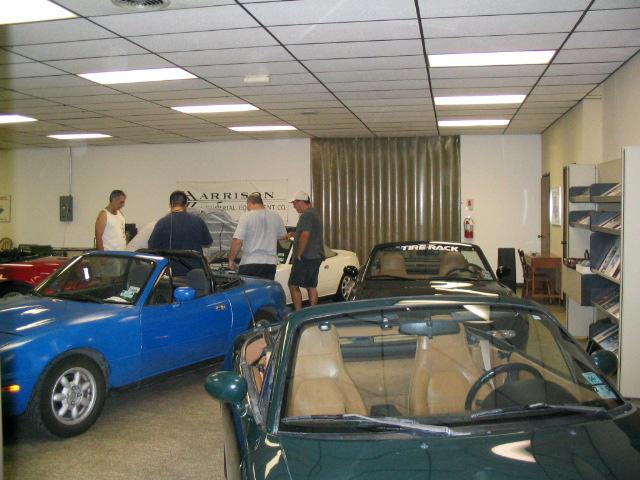

We had a surprisingly good turnout considering the really short notice!
http://www.harrisonindustrial.com/im...hday82204b.JPG
http://www.harrisonindustrial.com/im...hday82204a.JPG
How many Miata owners does it take to check the timing! :lol:
