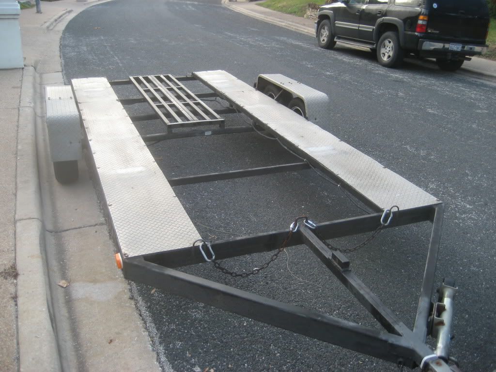

Well David, guess you could have saved some work and just rigged up something like this. :-)
Attachment 5611
