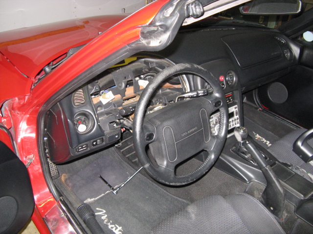

Yup... leaking caps. Look at the staining on the copper traces around C7 and between C17 and that CPU chip.
Also, that 1/2 black 1/2 white part to the left of the transistor with the heat sink is the thermal fuse wrapped inside a heating element. That transistor with the heat sink is used to activate the heating element and blow the fuse. It truly is a module that can commit suicide.
Well in College Station 2 weeks ago the airbag light started flashing code 52. On the way home at about Hearne, TX. we stopped for gas and the car started making 5 beeps from somewhere deep in the dash. Made it home fine parked it and drove my Toyota since it has beeter A/.C in the 100+ weather we have been having.
I take off earlier yesterday to run some errands with Evill KK and we decide to take the POSIV but she is as dead as a mackerel. No clicks no lights no nothing.
Hook up my charger and we just leave the POSIV sit.
This morning I walk out in the garage and the car makes the 5 beeps from somewhere deep in the dash.... I think I have a good idea what killed my battery..... No keys in it nothing but she still beeps??
Is the round deal marked TT92 in the following picture a buzzer of some sort?

Ohhh Ahhh all new and shiny!
https://lh4.googleusercontent.com/-A...0/IMG_0324.JPG
https://lh6.googleusercontent.com/-A...0/IMG_0325.JPG
Doesn't look any different that the original.
https://lh3.googleusercontent.com/-U...0/IMG_0326.JPG
Where did you get it?
Oh no it was made in Canada! Most Canadians only know how to drink beer and play hockey.
I was really hoping for one that said Hecho en México. But no I had to get the lower quality Canadian one.... http://smileys.on-my-web.com/reposit...da-flag-68.gif
A one year only airbag control unit. What did they get you for? Besides said daughter you were trying to protect...

What the heck lets pull that dash apart again....
https://lh5.googleusercontent.com/-s...0/IMG_0328.JPG
I'm hoping this airbag controller last more that 6-7 months.....
Well my Air Bag light came on today while on my way to work so it looks like I get to tear the dash out again. I was considering having it rebuilt, but after reading the results POS had I think I will pass. So Titus you still have that one from the 96 you parted out?
