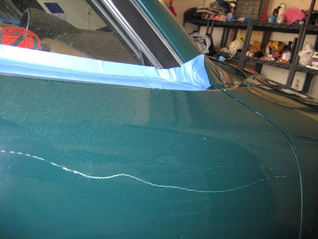

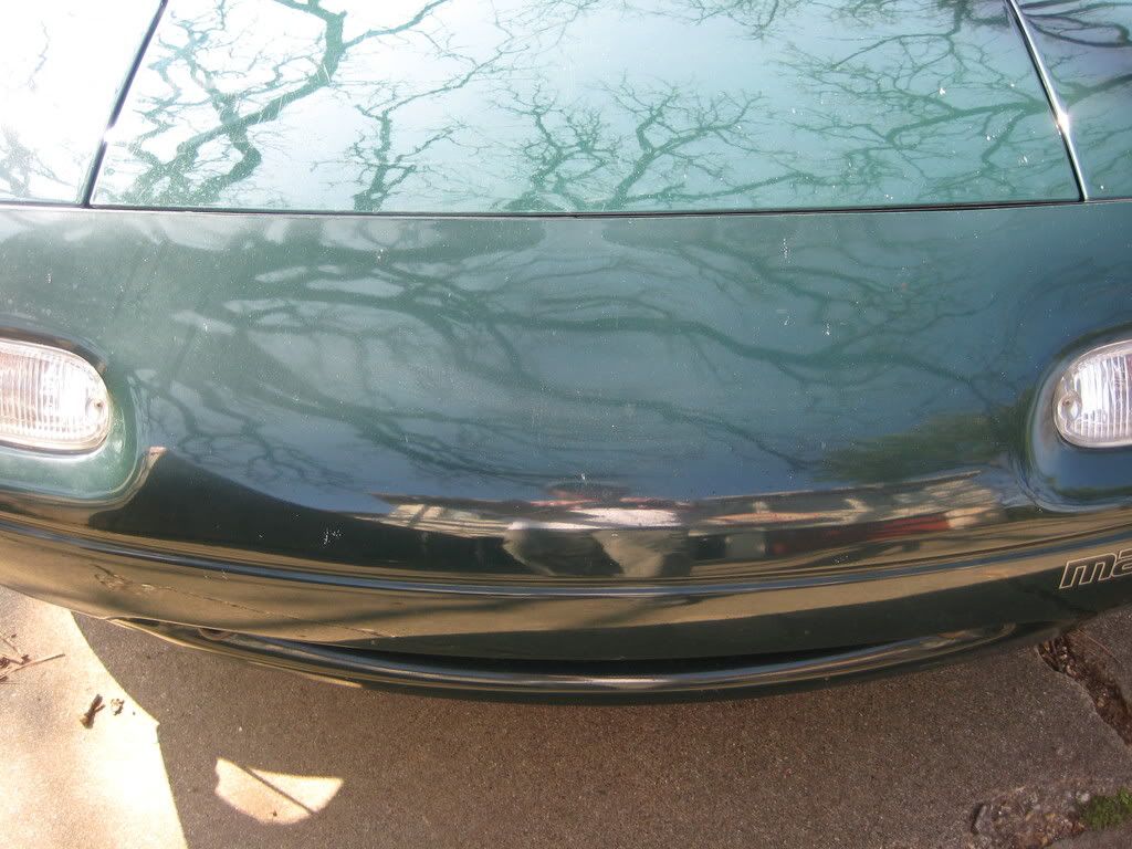

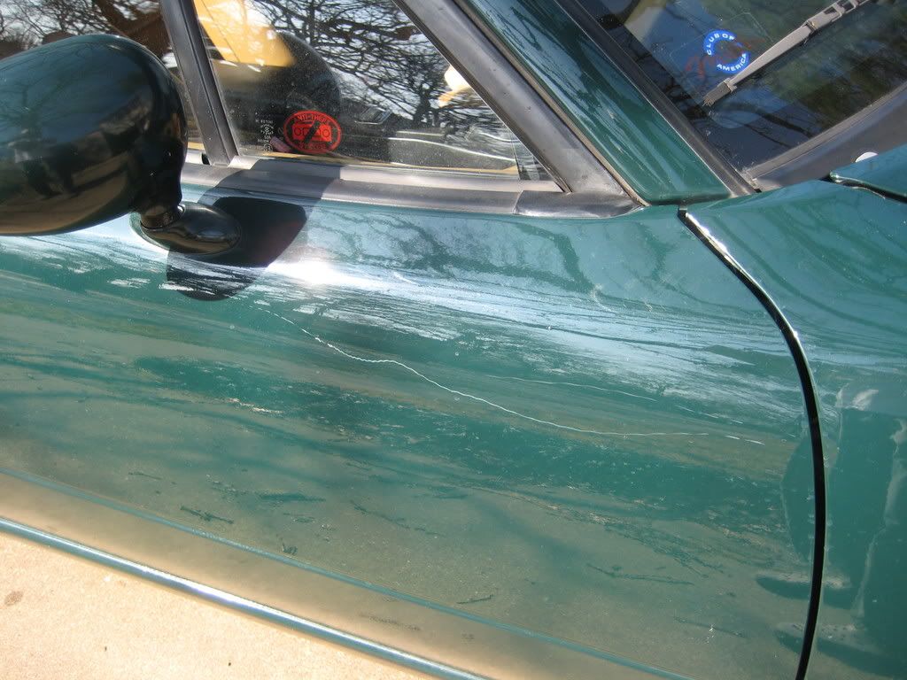

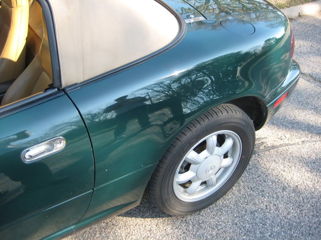

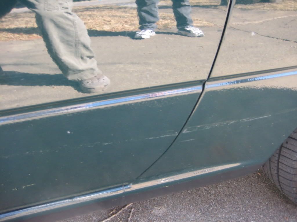

We got out some large scratches and got rid of some cloudy parts.
It really had a great result!

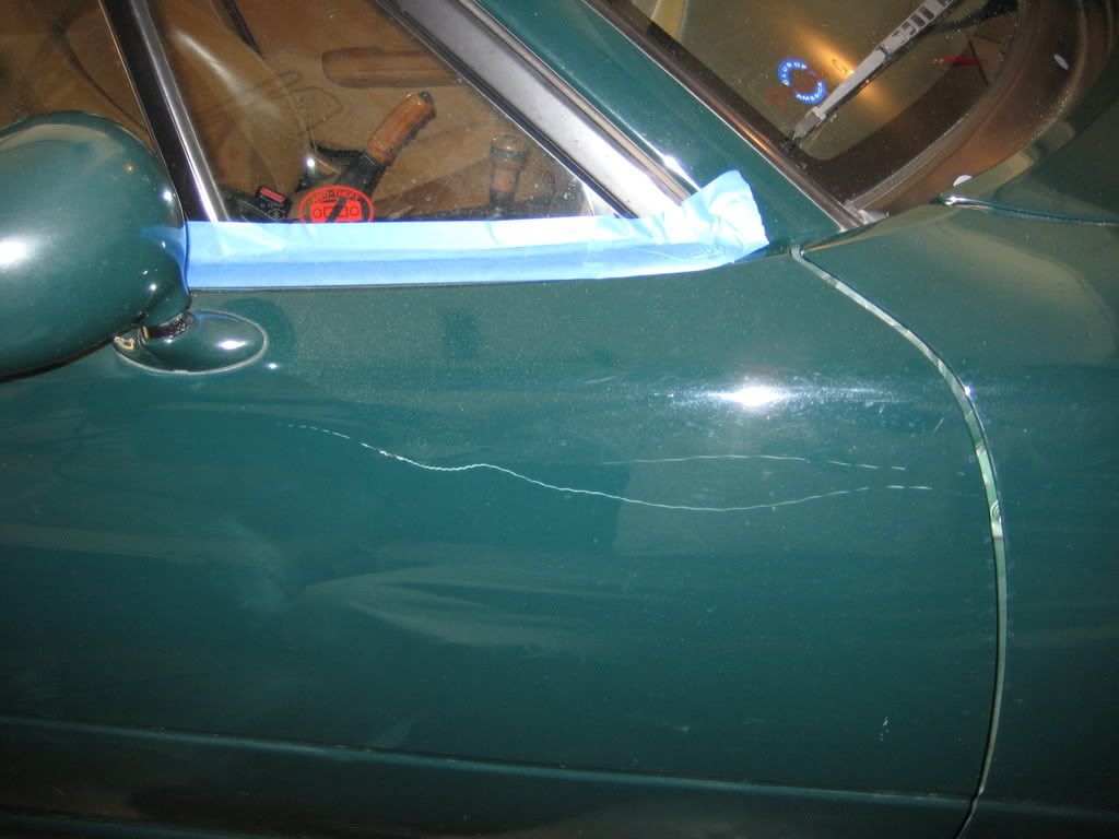

3) Paint Correction
Items Used: Blue Painters Tape (thick), Porter Cable 7424 w/ car detail fixings, mechanics gloves, spray bottle with H20. Details on combos below.

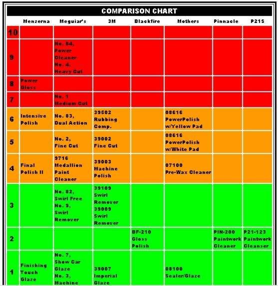

In order of light to heavy cut:
Light - Orange Pad w/ Pinnacle XMT 3 Intermediate Swirl Remover
Medium - Orange Pad w/ Menzerna Intensive Polish
Medium Heavy - Yellow Pad w/ Menzerna Intensive Polish
Heavy - Yellow Pad w/ Menzerna Power Gloss
Always start light and move up... as tempting as it may be to throw a yellow pad on fight the urge.
My Method:

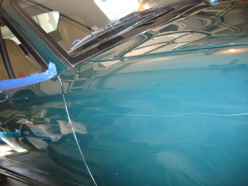

a) Tape off all trim, emblems, windshield nozzles on hood, areas where paint is near your conv. top, seals, door handles and antenna bases. You will thank me later for this step! ;)
b) Put gloves on... if you don’t you will have very raw and vibrating hands. Especially when you are on hour 3 of your detail.
c) Mist pad with water
d) Take Pinnacle XMT 3 and place a quarter size dab on the pad
e) Take the Porter Cable and smear the quarter size dab on the car in a 2 X 2 or 3 X 3 area (this reduces splatter).
f) Put Porter Cable on 4.5 Speed and work the 2 X 2 or 3 X 3 area for ~ 5 Minutes. Alternate applying pressure and allowing the pad to spin with a light touch. You will see the Pinnacle go from thick to a thin greasy layer... almost like it isn’t even there. Mist pad every few minutes. When done wipe residue off with a microfiber towel.
g) Don’t be afraid to retry the same pad and correction combo again before moving up the ladder.
*The learning process for me was to SLOOOOW DOWN and work the stuff into the paint. Before I would fire her up and go for 1-2 minutes... then go to a heavier cut. I have found that if you take your time you can do 80% of the things with a light paint correction and more time spent.
On really bad areas you can work your way up the ladder. Remember the heavier you go to try more speed... alternating between 4.5 and 6.5 on the Porter Cable and applying less pressure.
Remember the beauty of the Porter Cable is that it is pretty much idiot proof. You cant really hurt the paint unless you go yellow pad with Power Gloss applying lots of pressure (did that on my Mirror :( ). If you work up the ladder applying less pressure you will do fine. While it is good to keep your pad misted and the Porter Cable moving it is pretty idiot proof to burn the paint.

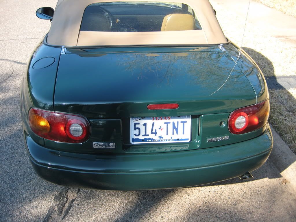

Stand back and admire your work!

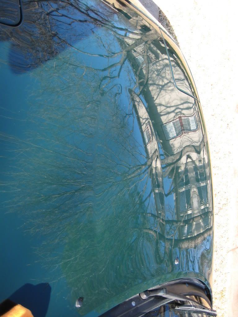

With clay, paint correction on the entire car and sealant expect to spend 4-6 hours.
After your initial paint correction and if you do a good job of using the two bucket method of washing on subsequent washings you should very little paint correction needed. In other words you can clay and use the One Step Acrylic Jacket and come in under an hour!

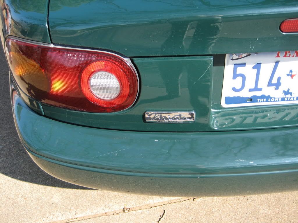

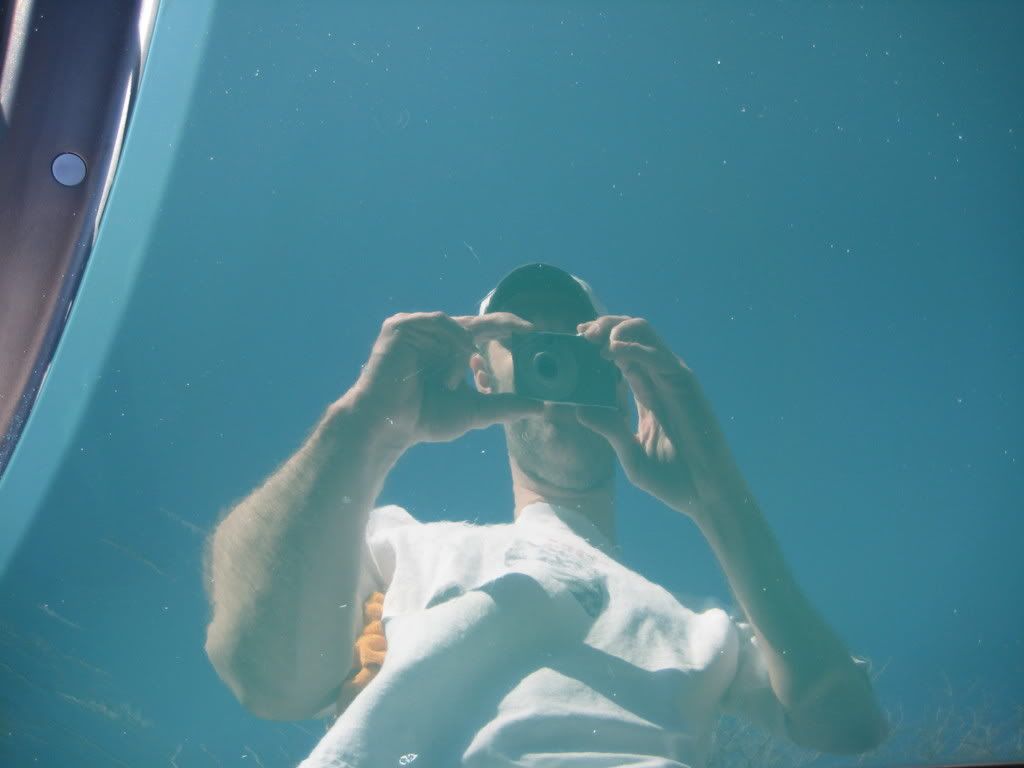

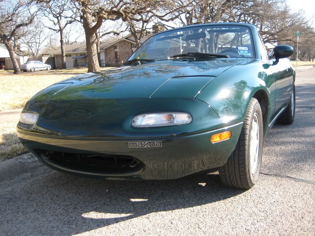

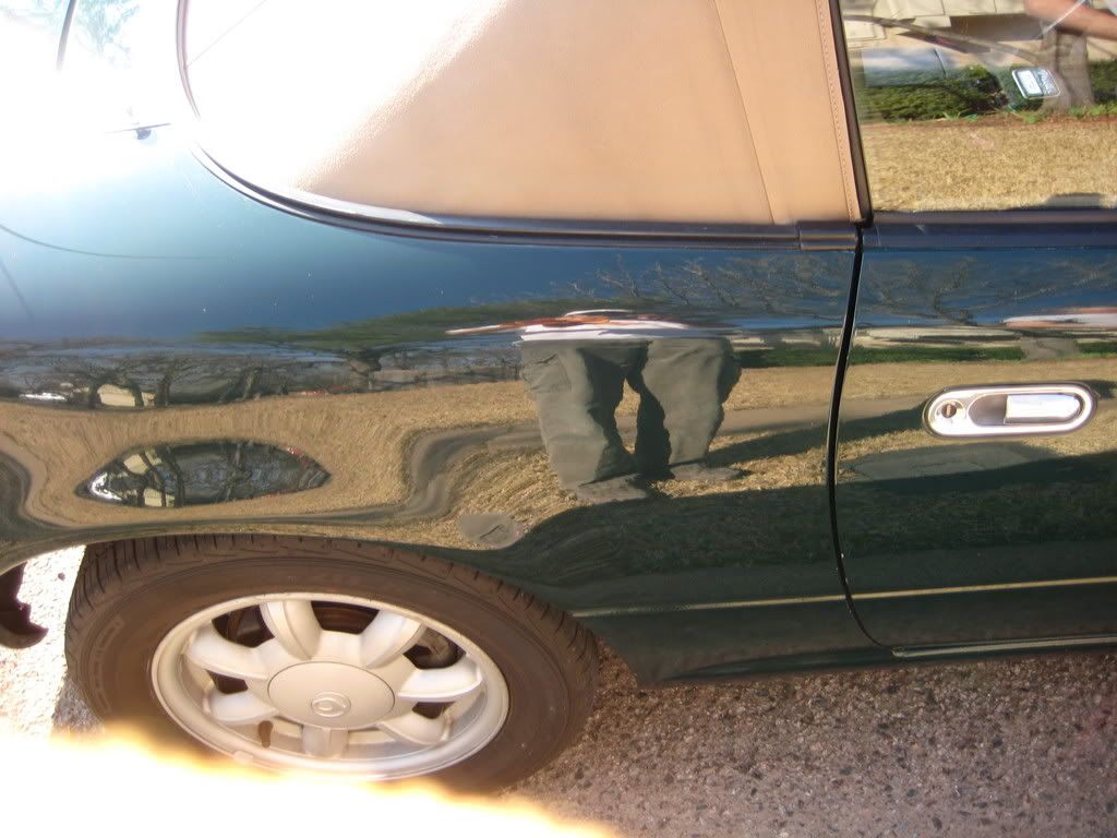

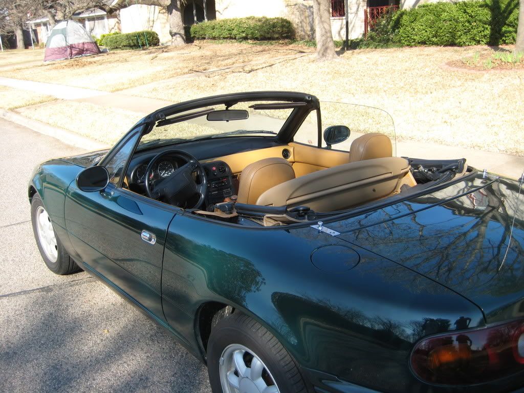

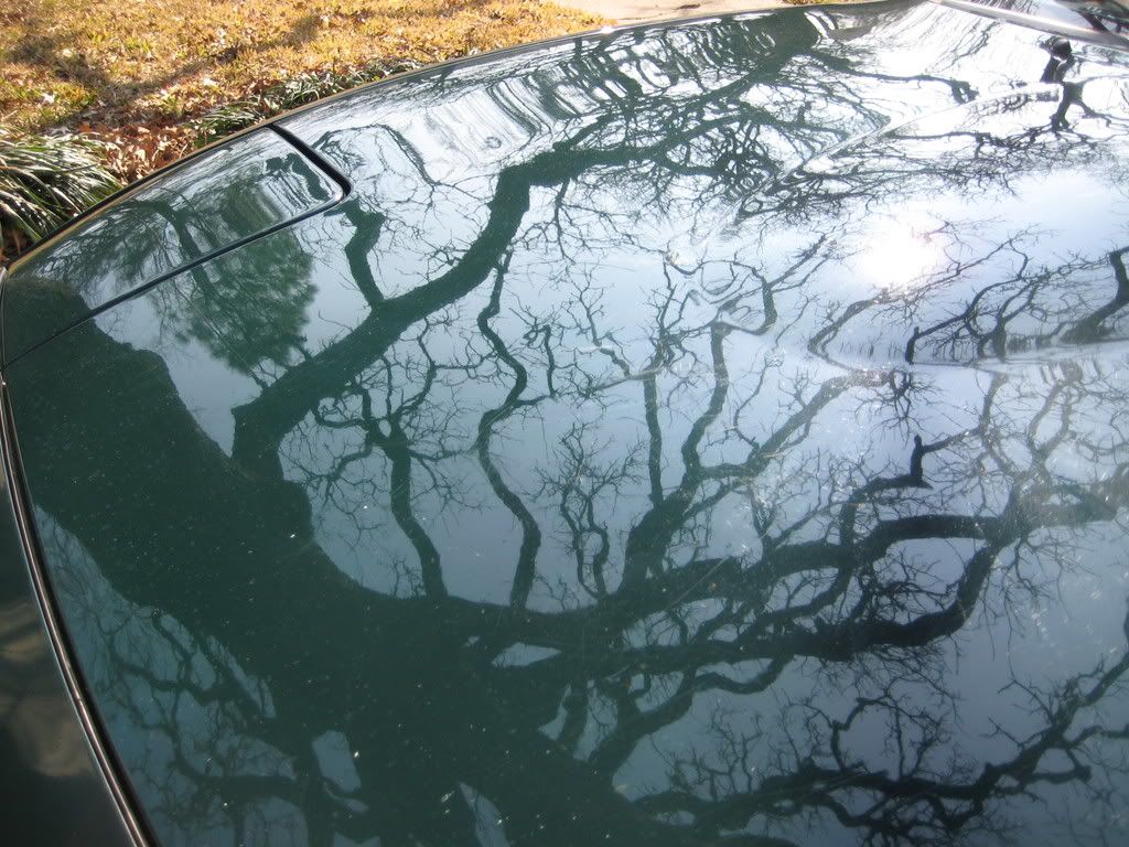

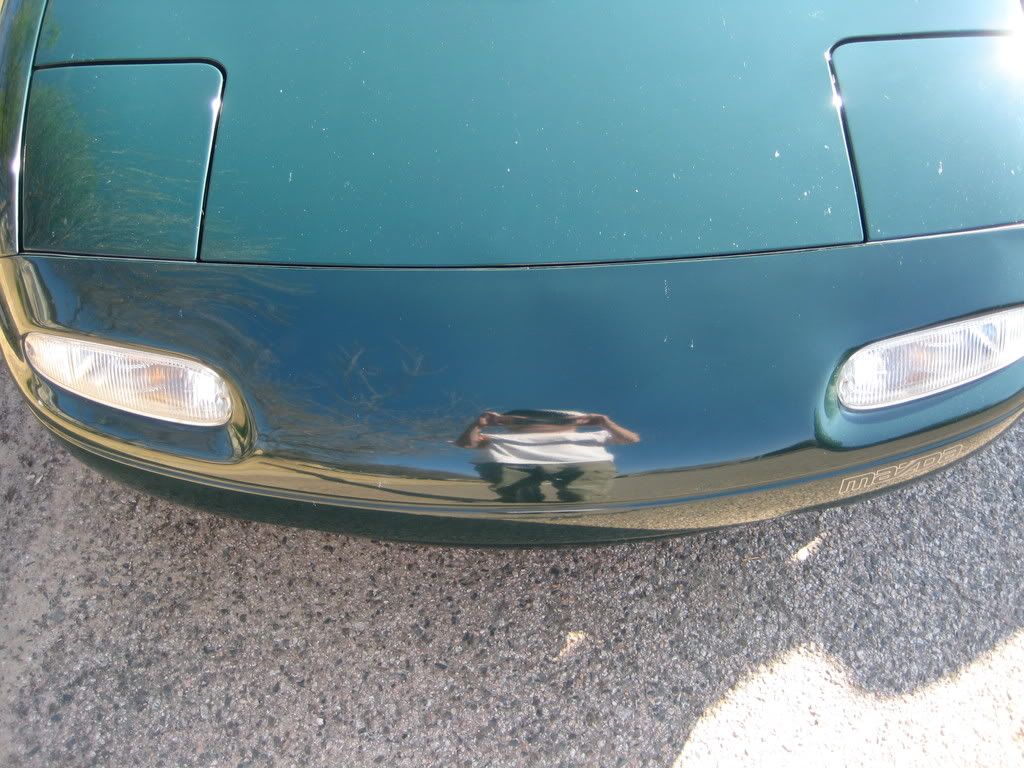

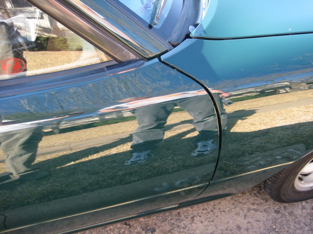

Now the pictures:

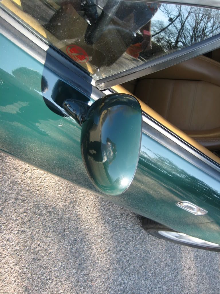

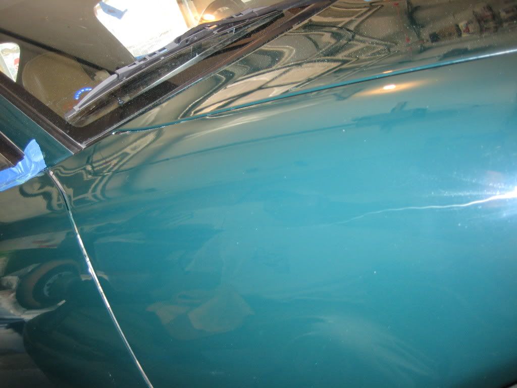

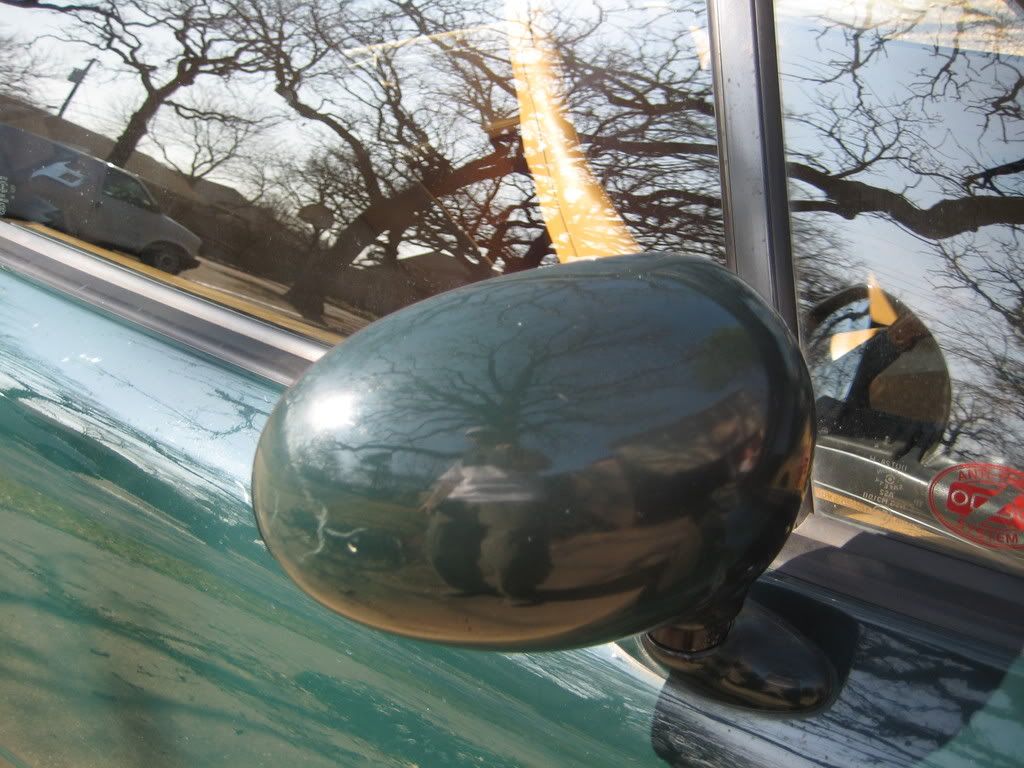

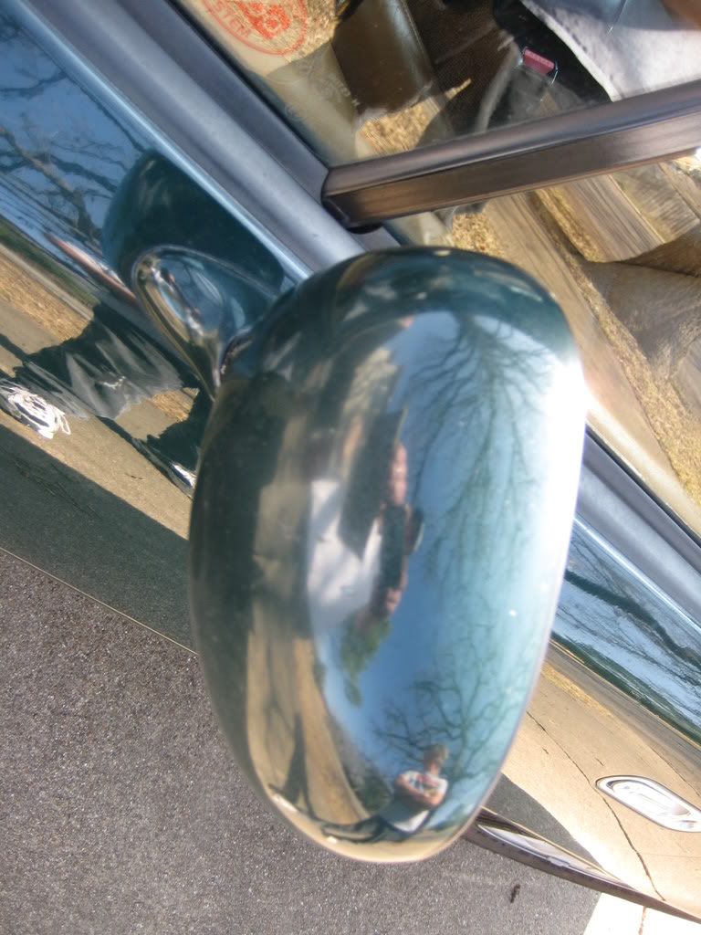

Before Passenger Mirror
http://i11.photobucket.com/albums/a1...rrorbefore.jpg

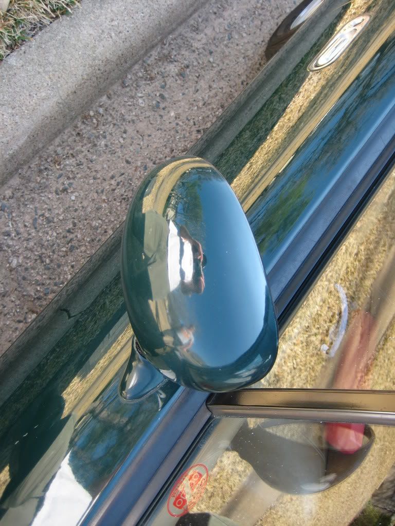

After Passenger Mirror
http://i11.photobucket.com/albums/a1...irrorafter.jpg
Before Drivers Mirror
After Drivers Mirror
