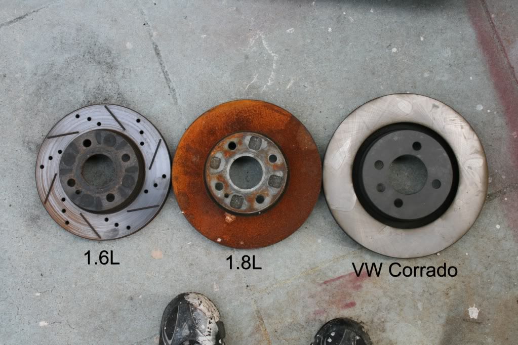

    This thread was a WTB: 1.8 brake brackets. I ended up purchasing these from a guy on the pointy board for $100 shipped.
    I upgraded to Corrado rotors while I was at it. Scroll down for pics and info.
    The brackets cost ~$100 shipped and the rotors were ~$50-$60 (for both) IIRC.

    1.6 Front Rotor: 234.7 mm
    1.8 Front Rotor: 255 mm
    1.8 Sport Front Rotor 275.5 mm
    1.6 Rear Rotor: 231 mm
    1.8 Rear Rotor: 250 mm
    1.8 Sport Rear Rotor 269.5 mm

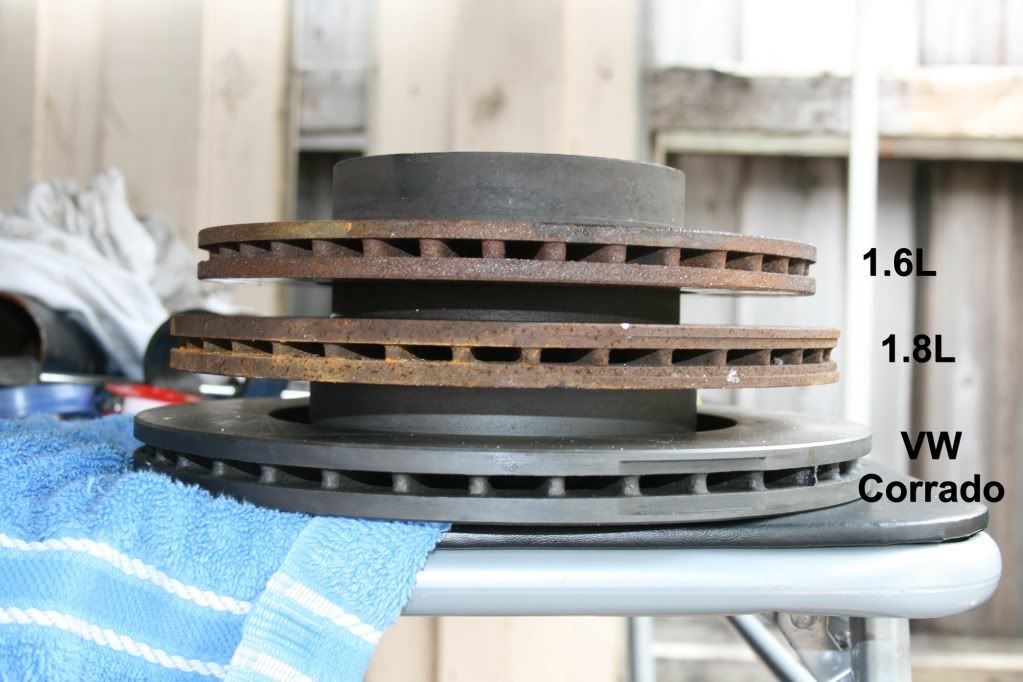

    So I now have on Corrado rotors (11.2") in the front with 1.8 XP8's (they squeal on the street) and 1.8 rotors on the rear w/ Mazda pads (I need a more aggressive pad in the rear).
    Comparison size of rotors via MiataTurbo, not my photos:
    More info:
    http://www.miataturbo.net/forum/t31946/
    To Do: FM's Wilwood proportioning valve and more aggresive rear pads.
