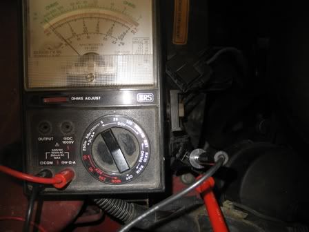

    Also looking at your picture you have then meter in the wrong end of the plug..... You want to check voltage going to the the fan motor.

    had realized the meter problem right after I sent it...DOH!!!
    tried it with the jumper on the diagnostic...car both on and off..
    and nothing. nada..zilch.
    does the meter look right?

    I question if that meter even works.
    I think you want to set the meter dial at 25-DCV. Is it OFF in the pics or at 5-DCV?
    Also the polarity matters on those old meters.
    Can check the meter a 9V battery does the meter even work??

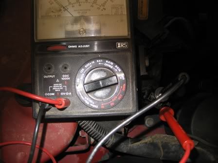

    The meter looks a little rough around the edges....(don't we all), but I believe it works fine. When I turn it to the Ohms...and touch the probe ends together, it shoots over to the zero. and when I tested it on a battery it did the same.
    Is there a way to check if it works properly when I set it to 25-DCV?
    The bottom pic is set at 25-DCV. The white dot at 12 oclock is the setting spot.
    Quote Originally Posted by perry View Post
    Ohms and volts are not the same.
    Can you set it to 25 volts and measure the voltage at the car's battery?? That way at least you will know it works.

    set the meter to 25-DCV..
    put on battery...it went halfway across....so I am guessing that would be about 12-13...
  13. #33
    Leave it set like that and recheck the fan's plug.
    Make sure you have a good contact with the jumper. I had to mess with it a touch before I got good contact to read 12V on mine.
    Polarity does count so try switching the leads if you get no voltage.

    then put in fan harness closest to car....nothing happened. tried with car on and off...and with the jumper on diagnostic.
    When the car was on...and i put the jumper on the diagnostic....then the meter didn't move..but i was hearing that same clicking sound from the main fuse box on passengers side.
