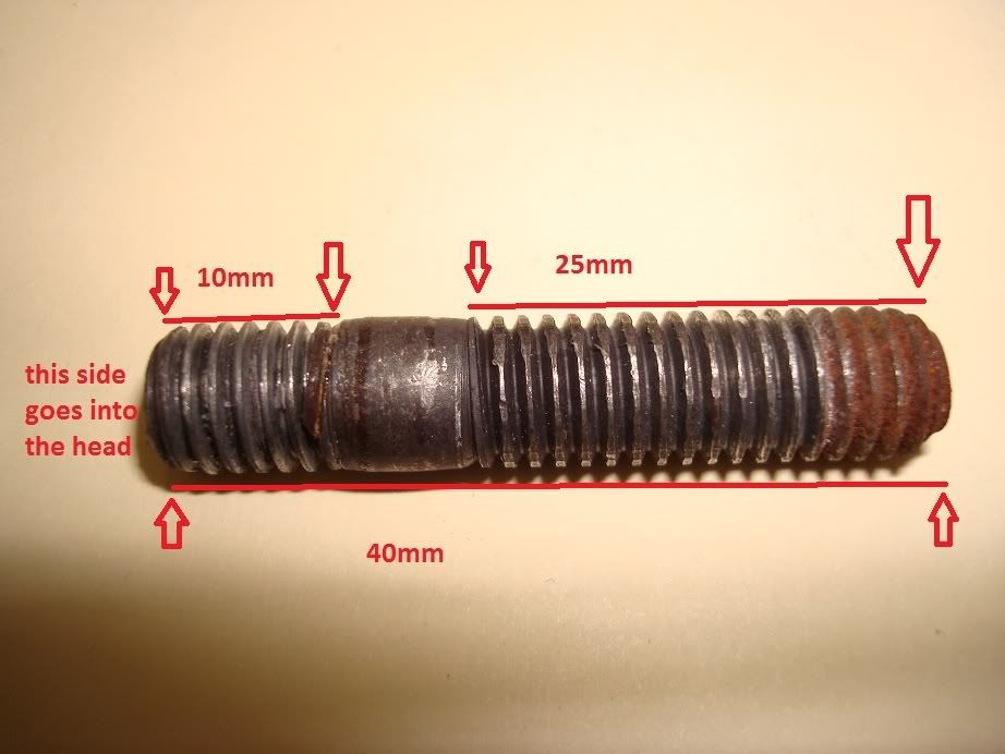

    I'm looking for a threaded stud M8X25X10 and having no luck finding something like that at HD etc. Anyone have a hardware source for something like that? Prefer automotive strength materials.

    Typically metric fasteners are listed in diameter x thread pitch x length. I'm not sure what an M8x25x10 stud is, but I'm guessing it's actually an M8x1.0x25mm, which is going to be harder to find. Standard thread pitch for an M8 is 1.25mm (M8x1.25).
    In metric, you'll want a minimum Class 8.8 fastener for an automotive application. Class 10.9 offers approximately 50% more tensile strength, but can be more susceptible to fatigue failure. I'd opt for a Class 8.8
    You might try McMasterCarr.com. What is this for?
    Sorry it's M8X1.25X10mm. It's for attaching an intake manifold to the head.

    I think the 10mm is the section that is threaded that goes into the head, I'll have to figure out what the overall length is

    Just getting the right stud length is tougher than it might seem. There are several DIN standards that are used to measure "unequal length studs", and it takes looking in books and pictures to figure it all out. There's usually an overall length (OAL) and a length of threaded stud on one side of the center shouldered portion. See what I mean below... That is an M10x80 stud, and in this DIN variation it has the same amount of threaded portion on both sides of a set width center section. It gets way more complicated when the two sides are different threaded lengths.

    Thanks Terry. Luckily I found someone that has a spare set they are holding and they will get all the measurements for me tonight. Total overall length, if it's threaded the entire length or has a break in the middle etc. I may take you up on your offer to swing by and pick up a few different sizes since I'm just down the road in Frisco to see what fits and then make a trip to one of the aforementioned hardware stores.

    Ok here's what I need. Mcmaster has something close. 45mm overall with the 10mm side going into the head (which is correct) and the side that uses the nut at 22mm (which is close). Not sure if the 5mm overall length and 2mm nut side length difference will be a problem or not.

    Quote Originally Posted by Robert View Post
    I think all thread would work fine.
    http://www.mcmaster.com/#all-thread-rods/=ah2hwl
    That's what I was thinking. Is there any reason that the threads stop and then start again? A fully threaded rod should just bottom out in the head and then as long as it's long enough and can fit a nut on the other end it should work right?
    Yep so you don't bottom out the bolt in the head and to keep you from crushing the gasket if ya don't know what your doing.
