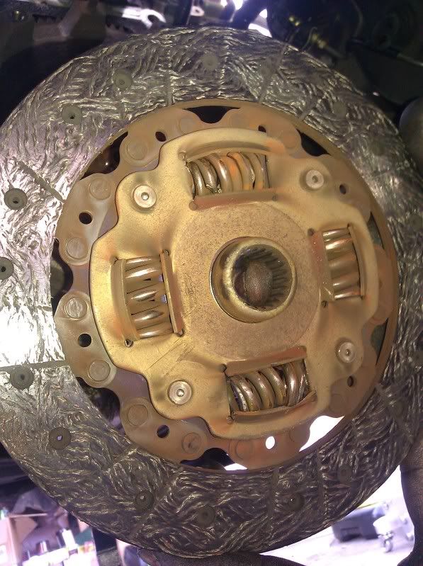

    FWIW, even you can wiggle the driveshaft and it makes the offending clank, still take a closer look. In my case the clutch springs/bearings were going out making clicking noises and allowing almost 1in of rotational play. The driveshaft(well, clutch) clanked when wiggled. Ujoints were still good.
    However in my case, in second at low speed, clutch out I could tap the gas and recreate the clanking noise. Might not be your problem, but something to think about.
    Take a look at the busted springs, the spindle was pretty much free to move.
    Edit, re-reading sounds more like something might be clanging inside the bell housing. The driveshaft/rest of drivetrain should be static with respect to clutch engagement. If the clutch fork got bent or something came out of allignment, could it cause the clutch plate to clang on something?
    In both my miata and honda those springs broke and did weird things. In the honda a piece of the spring wedged somewhere preventing the clutch from even releasing.
