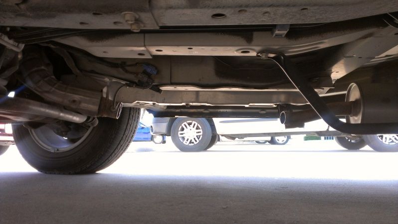

Something missing here?
Bit of a startle when I cranked the Element after work today. These sorry pieces of. Middle of the day, front parking lot at work.
Anyone know a good(cheap) muffler shop in the mid cities area? I'm too cheap for full coverage so i'm looking for a deal. What's the best way to go about this? Generic fleabay cat? If you see where they cut it looks expensive to fix correctly, but i'm guessing a shop could just weld a new one back in there.

I'd go fleabay and take it to Hercules Muffler on Carrol St @ I-30. Or junkyard Element cat from LKQ, if they sell em.
Rockauto shows a direct replacement cat for around $300.00 but looks like the flanges also got cut out of you system.....
Are junkyards legally able to sell cats? I thought there was some sort of federal law against it. I'd rather go that route to make sure I pass inspection next year if I could get the flanges welded back on. Well provided it was cheap enough. Thanks for the shop recommendation BTW.

Looks like only the rear flange to the catback was cut. The other flange is further up the downpipe, still on the car. Bad news is there's an O2 sensor in the cat i'll have to buy as well (pretty cheap on ebay though)....
I'll call the junkyards in the morning, maybe I can get lucky and get one with the sensor still in it, if they sell them.

Junk yards are not legally able to sell them. I'm now debating between the $300 OE replacement from Rock Auto, and the $50 ebay special. Any idea if the non Honda OE replacements will last longer than the reported "6 months if at all" for the cheapo fleabay cats? I'm not paying $750 for the OEM, but would only fork out $300+ if I knew it would last a couple years at least.
