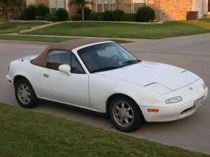

    93 virgin car (stock) belong to some lady (35 maybe) white/tan
    leather seats seem worn. 144k miles. valve cover gasket needs
    replacement, next week its getting new spark plugs/wires. 14lbs
    wheels (stock hollow ones). replaced the radio and took off the
    visors, no spare tire, a bit of hail damage, broken antenna/motor.
    no power locks but power windows, driver window switch needs replacement.
    windows go up reeeaaallly slow. abs and power steering...
    dunno if i should work on the 1.6L or swap for the 1.8L...
    i'd like to keep the 1.6L but its seriously weak, low oil pressure
    on stop lights, (probably thin oil)...
    I'm definately planning on making it out this coming wednesday
    unless its too cold... hahaa... the poor engine topped out at 105mph...
    thats serious weakness, pissed me off too.
    only picture i have of it

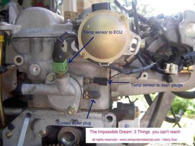

    Other things to look at. Rear CAS O-Ring. If it's leaking it will blow the hoses to the heater core.
    Not on the 1.6L... The CAS is on the other side of the engine than the 1.8L ones.
    If you do take the CAS out to look at it you should replace that little rubber cap that's on the back of the head. When it finally deteriorates enough to leak you'll go nuts trying to figure out where that water is coming from.
