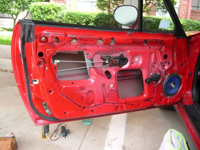

    Holy crap...I have power locks! heheheheh

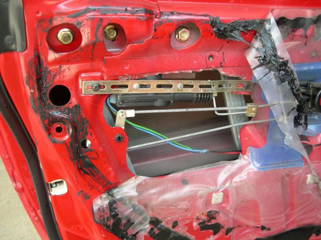

    Pulled off the plastic sheet, removed the power lock module and degunkified the metal.

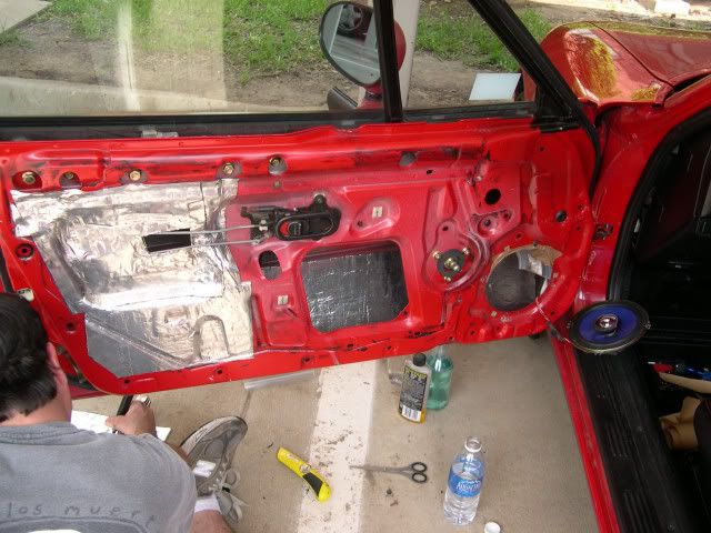

    Rolled in some Damplifier (not TCB approved) inside & on the door

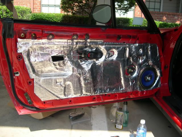

    Finished up the sound deadener (or as much as I cared to)

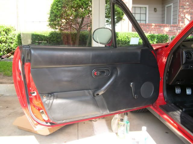

    Installed the squeaky clean, '94 door panel
    I was too toasty warm to do the passenger side, but sound quality has greatly improved already, and road noise considerably less! Only about 3lbs added to the door, too, if that.
