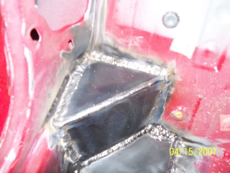

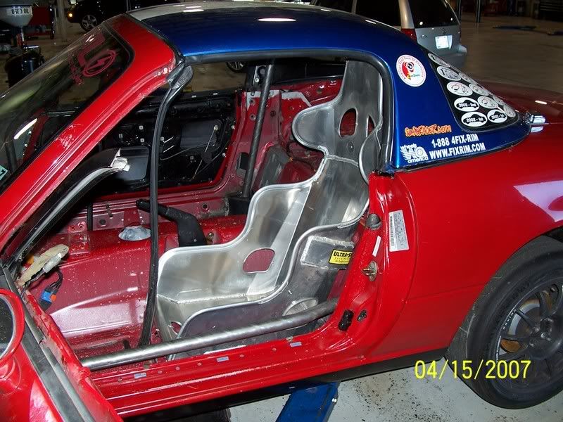

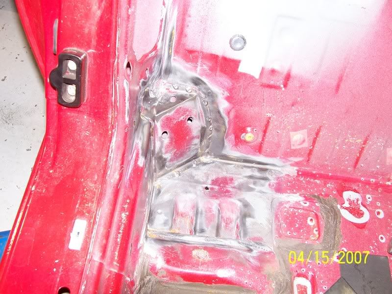

    Here is to day work.

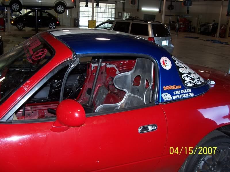

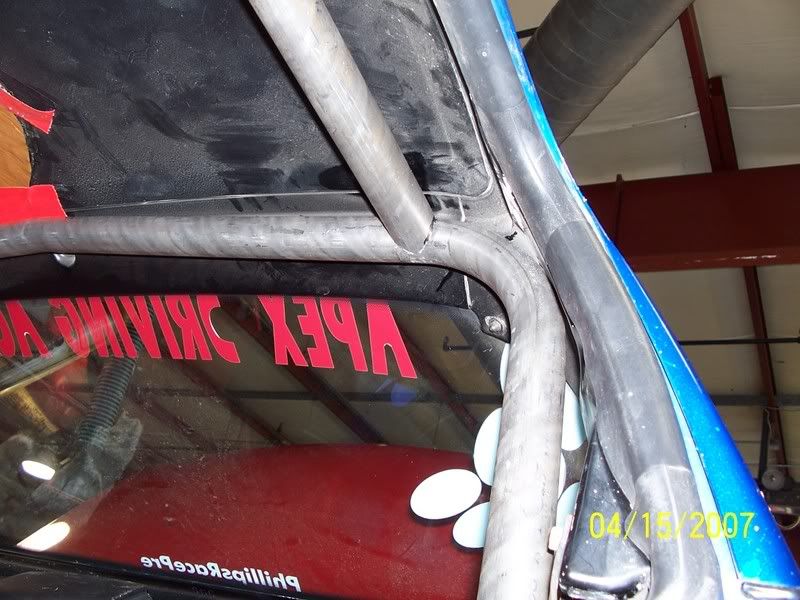

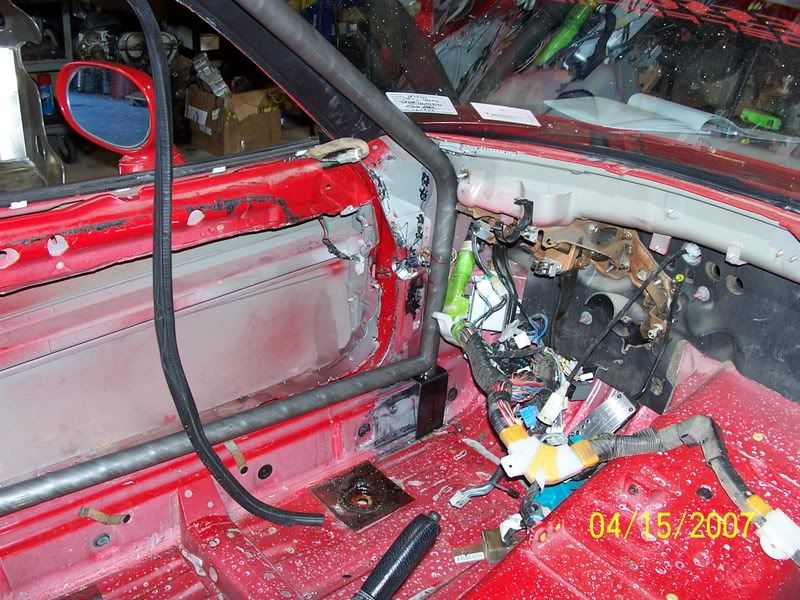

    That forward running bar off the main hoop(top) looks awfully far toward the center of the car. I hope you are short, otherwise your helmet is gonna be banging on that bar....not a good thing. While I'm being picky, are you sure you likw the down tubes of the main hoop tilted at that much of an angle? My first SM was done that way and I was always concerned. On my new one, I mounted the main hoop on the package tray so that it is almost vertical. With the mounting plate extending from near the seatbelt tower, down well past the horizontal sill, and up the side, I think it is stronger than going to the floor.

    The seat has 2" more to drop down on the floor.
    It is all just test fit so far. I am going for the most head room also to keep the cage away from driver as much as possible.
    So the seat makes the cage look lower because it is just sitting in there.
    I have got about 1"1/4 more head room from 79 SM car.
    It is best to be picky, or it never gets done right. I like the comments, it keeps your self thinking all the time on how every one car is done.

    Yead, David, I am pretty long-waisted and the bars need to be as far away from my head as possible, esp the side bar along the top of the driver window area. This thing gonna be ready for the enduro at TMS in early May? I want some serious time on the motor to see if it will loosen up and make any power.
