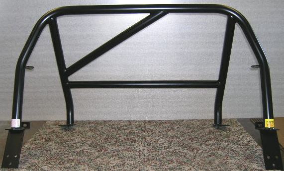

    The Harddog Deuce has support bars that you can't see (they run under the parcel shelf). The picture below shows one pre-installation.
    You can clearly see how it would add protection in a side impact.
    Now if we look at some of the other bars out there, we see that they offer varying levels of lateral support, but non offer a bar that goes straight across between the seatbelt towers like the Deuce does:

    Very nice comparison Titus. Not that it helps much but I decided long ago to go with the double hoop offered at GWR when I do upgrade my bars because I expect a far greater chance of side impact than rollover. But this bar can easily handle either.
