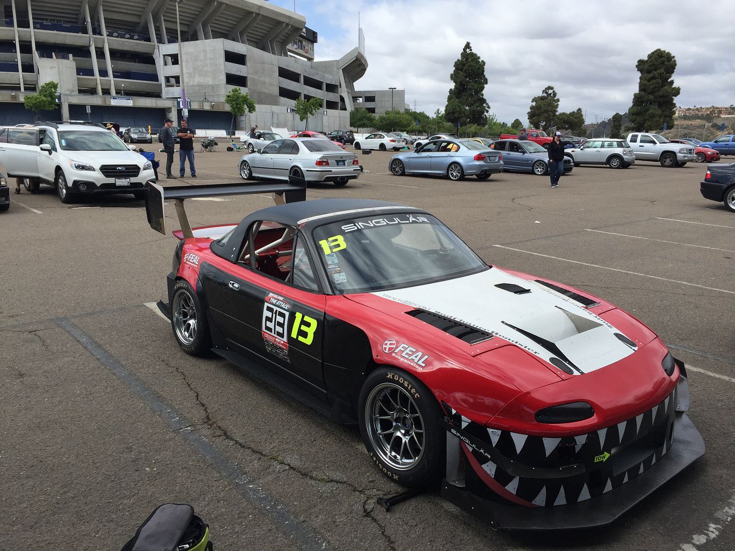

    Without rulebook holding me back... Something like this?
